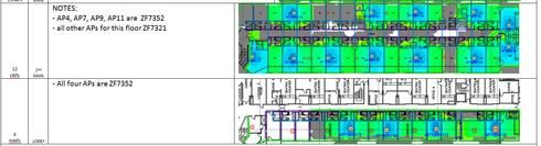

If you want two floors (i.e. you want to take advantage of AP reuse from a vertical location), you'll have to make educated guesses. For example, if there is an AP in room 201, and room 101 is immediately under 201, and you have performed an active survey (e.g. using your iphone/android running speedflex and a Ruckus AP), and see that you get 27Mbps and RSSI of -57dBm, then you can predict that a similar room setup down the hallway would be, uh, similar.
I suggest taking screenshots of each finished floor predictive analysis, putting them in stacked Excel cells, and evaluate feasibility of AP placement.
This works well in hotels. Here, I'll share one I'm working with you:
The red circles are just "AP exclusion area" circles I use to help me track where the APs are on the above floor.
HTH.
HTH.
