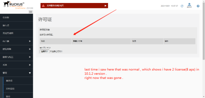

i upgrade my zd1200 version to 10.1.2 form 9.13 last time , that was perfect , everything is ok .
but this time , i upgrade version to 10.2.1 form 10.1.2 , the ap license was gone , and the supporting license was gone too ,

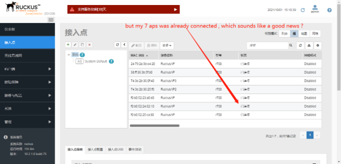

but according to webui shows , the aps were already configued and they were auto upgraded to 10.2.1 . it seems to their configuration is ok . it seems to the zd1200 and r700 aps still works normally .
i dont konw ruckus productions very much . so please tell me , what should i do next ? this status will affect my company to surf the internet ?
is it upgrade causing the ap license gone ? i never see that problem in the forums .
is it very bad phenomenon to me rightnow , this status will affect my company to surf the internet after few days ?

Image_ images_messages_6156b515c70d09623cfc5416_0e7ffcffaacd734d5caf72462fb6fcc2__20211001151003-bfe38e39-c8d7-42f8-83e6-37dd75764403-1821048323.png
ap license .
Image_ images_messages_6156b515c70d09623cfc5416_4f2559d5922d3959588b29d7dfd05f94__20211001151300-ffbb5d5f-7771-4835-b895-962a5ebab3c2-838692157.png

Hi Joe,
As per the serial number, controller has no valid support contract so first thing I am wondering how you upgraded the controller (for upgrade post 9.10 version, valid support contract is mandatory).
Now talk about the AP licenses. As per data base, your ZD has 5+5 AP licenses, total 10.
If APs are functioning, I don't think there is any issue but may a glitch in the GUI. Try a restart and see if that fixes the issue.
Also I recommend you to purchase the support to get official RUCKUS support for any device related issues.
