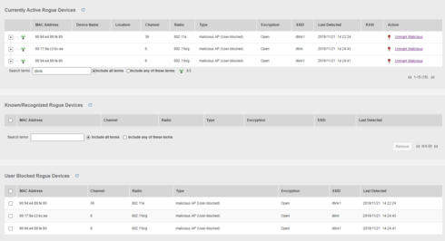

Hello. I want block rogue APs in my building. Zone Director correctly detecting APs
For simplicity. I turn on my d-link AP and connect their to internal network. ZD immediately reported that detected new malicious AP (Same-Network). despite the set parameter "Protect the network from malicious rogue access points.", i can still connect to d-link AP from my mobile phone and works with no problems and disconnects.
I misunderstand how this should work?

When you are testing using the D-Link AP, on the ZD under Services&Profiles >> WIPS & Rogue devices, are you able to see the Rogue AP (D-Link) under "Current Active Rogue Devices", "Known/Recognised Rogue Devices" & "User Blocked Rogue Devices"?
Can you get us the screen shot of the WIPS & Rogue devices settings?

Hello. Thank you for the reply.
Image_ images_messages_5f91c492135b77e247af347a_2546e3171372ea70a40dd12481a08d19_RackMultipart20191121876141tjl-bea2f38b-f3dd-4e06-ba86-83e5cb88270c-545851404.png1574335684
Image_ images_messages_5f91c492135b77e247af347a_0eecd9bab0a265b22c107783b5f47d77_RackMultipart2019112111760100x-356ac2ba-02fe-4318-bd06-b3c27d0c70c8-1672583264.png1574335742
And now i can connect my phone to dlink and dlink1 networks without disconnections. At this time strongest AP ruckus broadcasting at 6 channel, same as dlink.
Also i start sniffing in 6 channel. I not understand, I assumed that I would see a large number of deassoc frames... But maximum 1 frame per second and i think that this packet not related to AP "dlink" suppression.
Image_ images_messages_5f91c492135b77e247af347a_29fead4879862d0d4f17c3a8b1ccfb46_RackMultipart20191121851161p5o-743cb566-f05b-4bc0-92ae-a4c2b535e451-824244966.png1574336595
