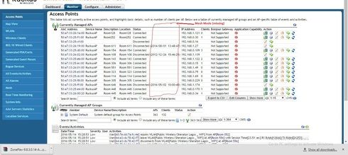

1. The two T301n could not mesh wirelessly, we realized that on the -- -- webpage, that is completely missing
Image_ images_messages_5f91c3de135b77e2478bd353_6f81b492ee63f6f739919a7093783a3b_RackMultipart201605151180921mn-6a817813-20c2-477c-a621-2031ff7092cf-657156016.jpg1463321144
We believe have seen the problem, we upgraded from firmware version 9.4 to 9.8.3.0.14. The aim is to include new devices like T301n, R700 and R600. Now upgrade is running successfully but now we want to mesh T301n(s), we enabled the mesh  but on the Monitor AP view, "Mesh Mode" seems hidden or not available.
Please how do we include this Mesh feature of ZD3000 v9.8.3.0.14 successfully? We really need this wireless mesh connection

Mesh is not supported on 802.11ac using the 9.8 firmware series. IIRC you need at least 9.10 to support 802.11ac mesh.
(BTW for urgent support, it's probably more efficient to go through Ruckus Support and file a ticket. We are just volunteers here who love answering wifi questions in our spare time)

John is correct, minimum load for AC Mesh functionality is 9.10
