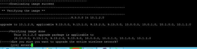

i have network with ZD3050 and AP 7352
my current controller version 9.5.0.0 build 156
is there last safe firmware for ZD3050 and AP 7352 to upgrade ?

You can upgrade your controller ZD3k to build code 10.1.2 which will still support AP ZF7352. These AP model's are not supported from 10.2 and above. Below is the article that would help you with upgrade path which is required while upgrade to keep the current config of system intact.
https://support.ruckuswireless.com/articles/000001845
Note : Always take the backup while upgrade and post upgrade of one code of controller wait for the AP's to update the new code too and then go to next code.

@syaiful_umar
I am unable to identify your existing version of ZD? You need to be on below version before upgrading to 10.1 to keep your config intact. If you are not on any of below code the ZD would go to factory default setting (you will lose all configuration on ZD).

Hi  @syaiful_umar
Unfortunately answer would be no. You can restore config backup taken from 9.5 to only 9.5 code controller and not on 10.x or any other.
