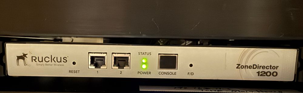

After I turned off and on the power, the status light stays solid green on Zone Director 1200. I could not do F/D reset! I repeated the process multiple times. It doesn't work each time! Can anyone help? Thanks!
06-30-2025 08:56 PM
Can I do a hard reset by using Console port? If so, how?
06-30-2025 10:56 PM
This is how ZD1200s die. Hopefully you're the original purchaser, and can contact support to get an RMA.
