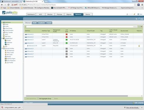

we have set up on interface 4 on the palo alto (which is the internal link) a 4.99 for the vlan so the traffic goes through (see image as I don't think this makes a lot of sense) Image_ images_messages_5f91c416135b77e2479585d0_57a54e215029a6c7a5c24c108e91b911_Interfaces_inline-0f503d78-d1a1-45aa-975d-8625a20ef162-1695373253.jpg1415363300
Other than the guest network, nothing else is on the network. The AD server that the ruckus uses is on the 10.35 network, and I can see that the ruckus identifies the user accounts ok etc, I'm just trying to find a way for the firewall to see it, so the same filtering rules can apply.
