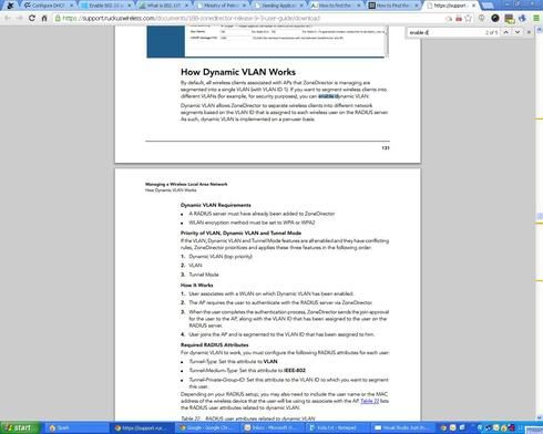

Adding to that, the manual of ZD 1100 says that a radius server along with WPA/WPA2 encryption needs to be set. Is the radius server mandatory as i have setup a stand-alone network (Consisting a Switch, access point, ZD and a PC) which is isolated from the main network ??
