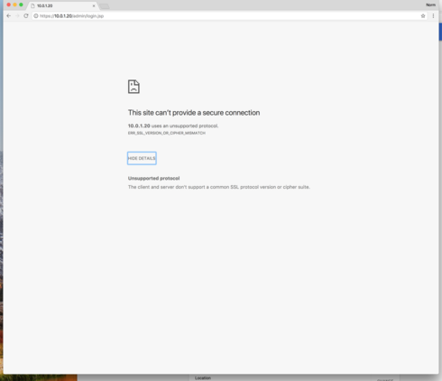

Since upgrading to High Sierra, and maybe earlier, I have not been able to connect to our ZD1106.
Safari "reports" : "....can't establish a secure connection to the server "10.0.1.20" "
Any suggestions for this old beginner appreciated.

normharris3
What I get from both Safari and Firefox is somewhat different.
See below. Thank you for trying to help.
Image_ images_messages_5f91c434135b77e2479b6c40_a1f8b8db448dbe4c6a8df2982888c172_RackMultipart2017112998996yrex-2fd5acd4-459d-4b28-bd9d-030468261814-2019754790.png1511967717
Image_ images_messages_5f91c434135b77e2479b6c40_a3e68537dab78870199b4893fddaa40b_RackMultipart201711291008051fv-3929127a-fe7c-4216-8866-451f3404560a-1881796579.png1511967747

Your ZD is running an old firmware, that does not support the SSL requirements of modern browsers.You might be able to enable it, but I would quickly use the WPA KRACK support option to get the latest possible FW for your ZD.You have until dec. 31. to do so, according to Ruckus. They will grant you a 24 hour temp support contract when you do so.
