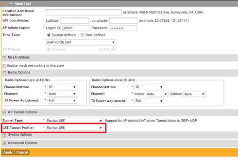

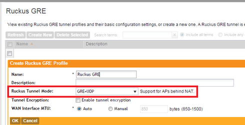

If you have a  firewall, ensure that that LWAPP and SSH ports are made available.
Finally if the AP is behind a NAT, ensure that you configure a Ruckus GRE Tunnel profile to support AP's behind a NAT and push that to your zone:
Image_ images_messages_5f91c42e135b77e2479a62e7_814b28d107be67067aa8abaf37f88749_RackMultipart20151102278511wsg-4c1785fd-48fa-4657-88dd-7e2bfdec0dee-767814247.png1446463049
Image_ images_messages_5f91c42e135b77e2479a62e7_fdba97c0a65768a5bd0f7d9d77ddac0b_RackMultipart20151102181921ps7-7a75b4b9-2e3e-4e55-8423-4604dbbe72b0-713625399.png1446463062
