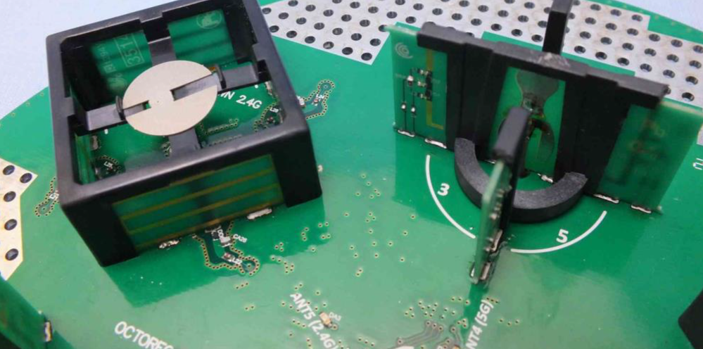

1. Beamforming may be client-dependent theoretically, do you have ever seen client-dependent beamforming implemented and working? I haven't.
2. I became really curious (you are right, from whitepaper conclusion can't be done, as WP is not written by technical people for technical people). So I looked on fcc report, which is really technical source: https://fcc.report/FCC-ID/I88WAC6503D-S/2472776 and description there is quit different. I found that this AP really seems to be similar to clone of Ruckus ZF2942, each antenna has (at least it looks so) 4switchable elements, and there is FPGA to switch them.  In this case this AP can provide real beamforming. It is interesting, how it corresponds  with Ruckus patents, but it is possible, that patent for this old design without  PDR is expired, or even sold, or there is a way to ignore it. I don't expect Ruckus commenting on that, but it would be interesting to know. There is another china vendor, which is openly copying Ruckus Beamflex, difference is that his equipment doesn't really work that well...
eizens_putnins
Valued Contributor II
Image_ images_messages_604b627036d47e6c85ad8b62_a356faf7559101584930dc3e3bc4abdb_Antena-fde55c99-b70e-43ba-adc5-67a320b34183-1846392940.png
Antenna close look.

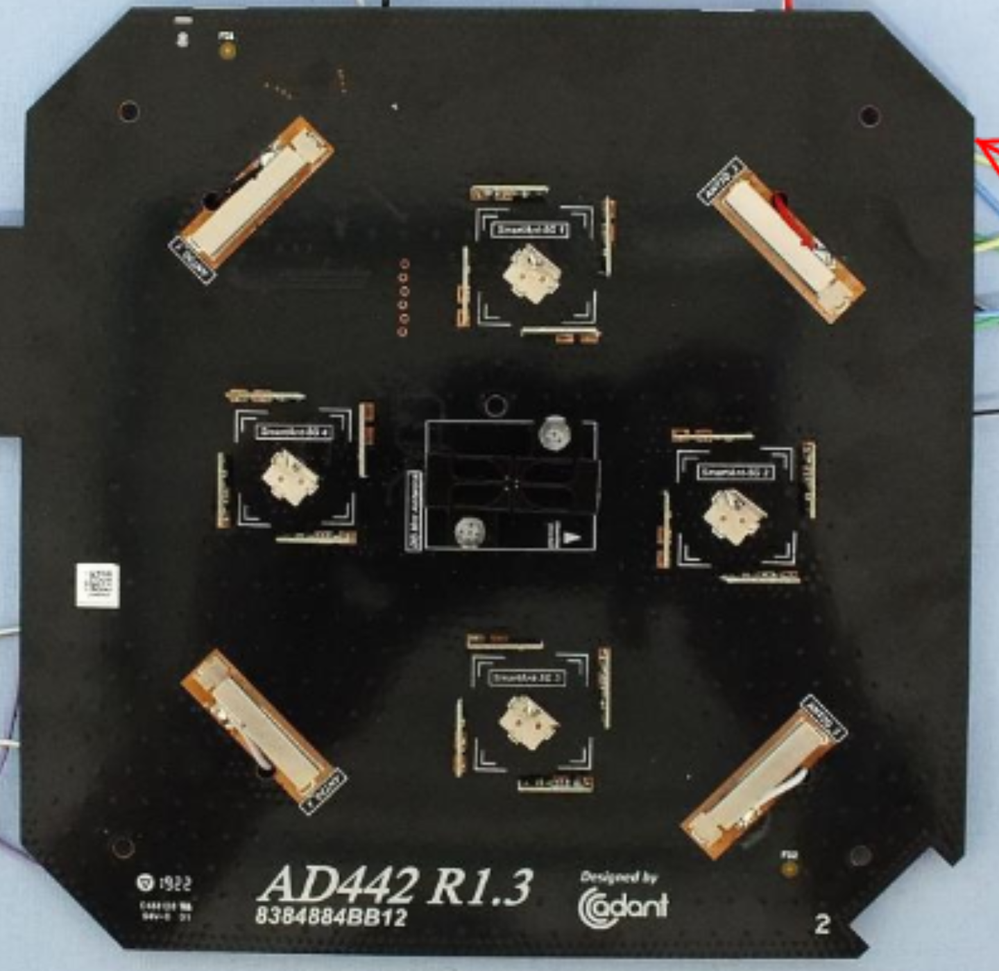

Did a little bit more digging as well. Picture below comes from their WAX650S. Googled the company, adant, and it turns out they specialize in designing smart antennas. They've contracted zyxel and d-link according to the following article. https://wifinowglobal.com/news-and-blog/adant-smart-antennas-can-boost-wi-fi-speeds-from-close-to-ze...
Image_ images_messages_604b6b0736d47e6c85ad8bf7_bc3d80dd906194887cb332518c664d55_Screenshot_202103120808042-7d294cda-5d12-4ab1-8bb3-3f593d56feea-121574943.png
interesting...
