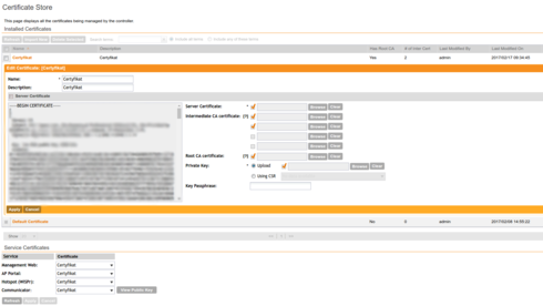

Then I made the backup from the first server and have restored it onto the second new box. I’ve connected one AP ZoneFlex R700 to it and everything seems to be working fine but I have a problem with https certificate on the Web Authentication Portal
I’ve uploaded my company certificate to the Certificate Store and set it on the Management Web, portal AP, Hotspot (WISPr), Communicator. After logging on to the network via wifi, the portal site displays a message“This connection is untrusted”- I’ve checked this and this certificate is from Ruckus

After reading User Guide “How do I get rid of the certificate error presented to customers when they connect to an SSID using WEB authentication  Knowledge Base  Ruckus Wireless Support” we found that with our certificate (Wild Card) need Root CA. We uploaded this certificate too but after login to portal we still have communicate “This connection is untrusted” and certyfikate is from Ruckus. Bellow screenshot with certifications
