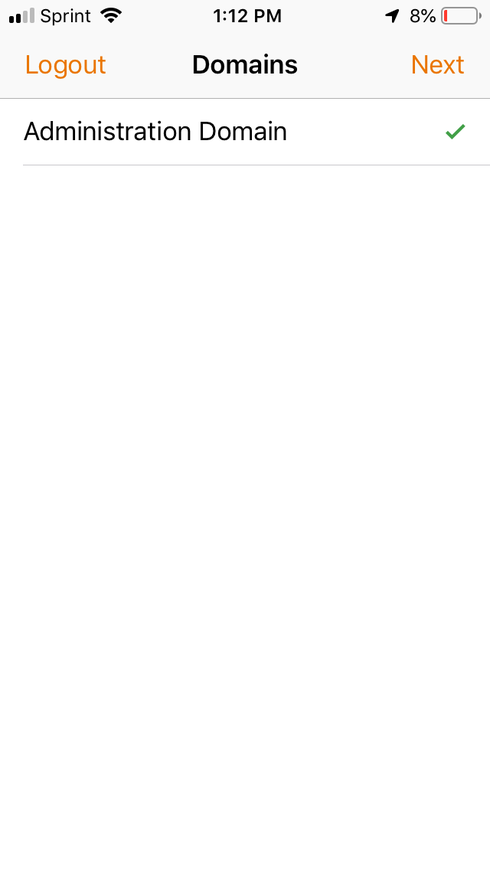

I am planning to use SWIPE to register APs and place them in the staging zone until I am ready to configure the WLANs but when I login through SWIPE, I am not able to see the staging zone.
I login
The Administration Domain is available so I click Next
No Zones Available.
Any ideas on how to proceed?

Hi Ankush, I am using the High Scale version of SmartZone. As you can see of the image, the Staging Zone is not there and the "Done" button is grayed our so I can not proceed.
Image_ images_messages_5f91c485135b77e247accf19_a8934f86a9c609f7705e895da188c762_RackMultipart2019060347830d714-0f1c8c58-441d-4284-b28b-ecee1444b68a-1565748221.png1559582079Image_ images_messages_5f91c485135b77e247accf19_cad214509c664b23ea5dbc496a184878_RackMultipart20190603547411aod-5b05eabf-67d0-4105-92a2-2ff2f4c3b596-1652123105.png1559582110
Could you please provide the Model of the AP you are using to onboard and version running on the vSZ?

HI, I am using R710s and 310Ts. I had to login the controller and create a new zone. I was never able to see the staging zone. I believe is bypassed when using SWIPE and High Scale.
