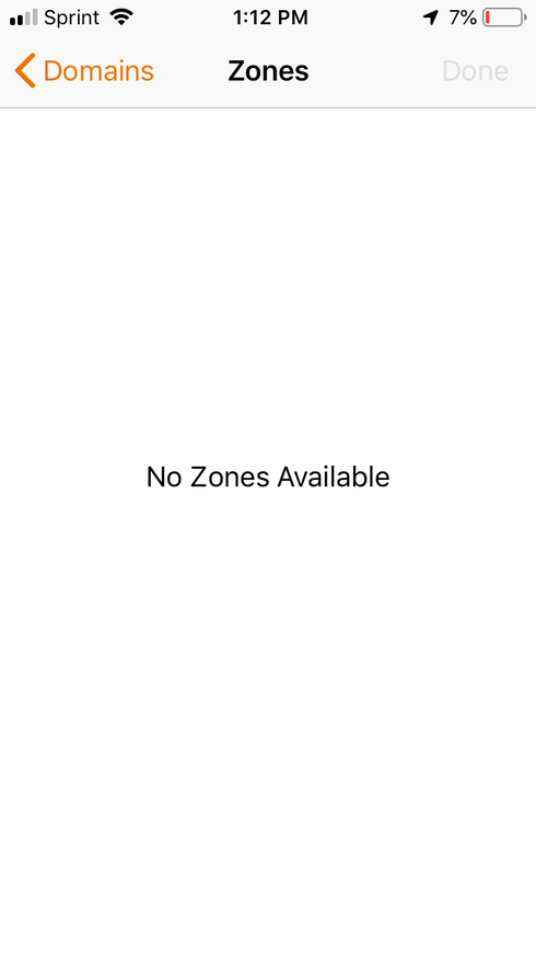

Good afternoon,
I am planning to use SWIPE to register APs and place them in the staging zone until I am ready to configure the WLANs but when I login through SWIPE, I am not able to see the staging zone.
I login
The Administration Domain is available so I click Next
No Zones Available.
Any ideas on how to proceed?
Thank you,
I login
No Zones Available.
Thank you,

Hi Ankush, I am using the High Scale version of SmartZone. As you can see of the image, the Staging Zone is not there and the "Done" button is grayed our so I can not proceed.

HI, I am using R710s and 310Ts. I had to login the controller and create a new zone. I was never able to see the staging zone. I believe is bypassed when using SWIPE and High Scale.
