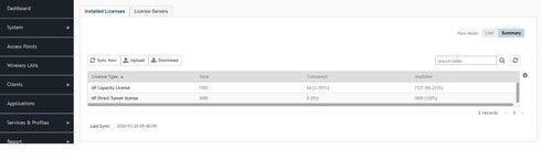

I have a little problem. When I go to Admin/Licenses and click on summary I still do not see 360, but I see this:
AP Capacity License
1585
60 (3.785%)
1525 (96.215%)
AP Direct Tunnel license
3000
0 (0%)
3000 (100%)

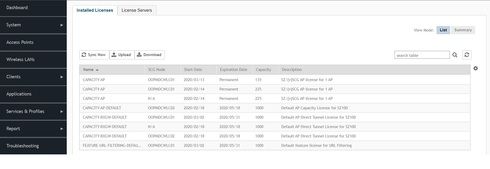

I am not sure why. I know that licenses are not activated under our company name but I should see them when I log in on controller? By the way when I click on "List" I still see 225, and in the other row 135. Any advice?
Dear Milan,
Could you share the screen shot of Administration>>Licenses (View Mode:List) page ?
The 1000 are from 90 day trial licenses that come with SZ100, others can be inferred upon looking at the installed licenses.
Abilash PR.
Greetings Abi,
Thank you for answering in short period. Of course I can.
Image_ images_messages_5f91c484135b77e247acb59b_2cbbe732993bd5da1798f1feb6e26879_RackMultipart20200320958731s8s-ce65cf49-efc2-435c-842c-3e8352e11243-332060431.jpg1584696501Image_ images_messages_5f91c484135b77e247acb59b_ba12f12a319fbd4b4593119797ef15d5_RackMultipart20200320114021tbn-bb403975-f6f7-4d11-a3f4-4ba84c7a639b-185245119.jpg1584696513
Hi Milan,
Thanks for the share, it looks good to me.
According to the licenses that are installed on this controller there are 1585 AP licenses (1000 trial (expires on May 18 2020) + 225 + 225 + 135 ) 60 are consumed. I am not really sure why you are seeing 225 licenses twice, probably checking about this with support would give us some answers.
Hope it helps!!!
