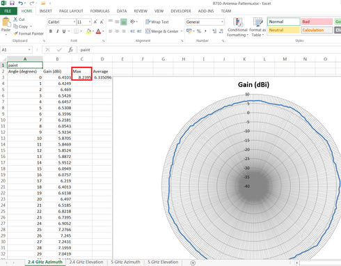

Thanks for this! Can you point me to where i can find the 5dBi and 8dBi is listed? As per data sheets i can only find a 3dBi physical antenna gain for both the r500 and r710 and the beamflex sinr tx gain would be 4 and 6dB. Maybe I'm missing something here?
As for the heartbeat loss this actually happens also during the night where there is zero traffic happening. Anyway I will check on what is happening once this has been turned off. Positioning has already been optimized having them horizontally but actually facing upwards instead of downwards cuz mounting them on the ceiling is a no-go. However I think the orientation whether facing up or downwards wouldn't matter for the signal strength I guess.

Don't see a 5 or 8.
I am using the data from the antenna mask patterns that I get direct from Ruckus.
Dont believe the spec sheets as they are always way out 🙂Image_ images_messages_5f91c46c135b77e247a7a099_3b2bd65739b60242b768b00d95e16926_RackMultipart20170202116067sts-d7b49745-d582-46ce-a18a-3bcfc3ff0f44-2050755831.png1486057221

Thx for clarification! That helps a lot. Any chance to share the antenna gain for a r600 or r610 if you have it at hand without any hassle?
Br Max
Yeah sure the r600 is:
2.4GHz: 9.1dBi
5GHz: 8.6dBi
I dont have the r610 as we dont use it, we only use the r510 and r710.
Note: The r500 and the r510 are both 5dBi, so it's safe to say they are using the same antenna in the r610 as they are in the r600.
Hope this helps, and good luck with sorting out your MESH issue.
