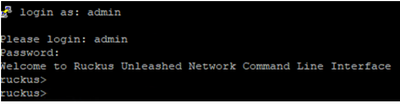

Hi  @jp
Execute Configuration Commands
Once the upgrade is complete, please proceed with the following steps:
Run the following commands:
(Please replace your Wi-Fi name” with your actual Wi-Fi/SSID name, enclosed in double quotes if it contains spaces)
ruckus> en
ruckus# config
ruckus(config)# wlan "your Wi-Fi name"
ruckus(config-wlan)# no qos directed-multicast
ruckus(config-wlan)# qos directed-threshold 0
ruckus(config-wlan)# end
ruckus(config)# end
This configuration may help resolve the issue.
Here’s an example of PuTTY command line output from my lab for reference: (Bold fonts are commands to execute)
login as: admin
Please login: admin
Password:
Welcome to Ruckus Unleashed Network Command Line Interface
ruckus> en
ruckus# config
You have all rights in this mode.
ruckus(config)# wlan "Your Wi-Fi Name"
The WLAN service 'Your Wi-Fi Name' has been created. To save the WLAN service, type 'end' or 'exit'.
The command was executed successfully. To save the changes, type 'end' or 'exit'.
The WLAN service 'Your Wi-Fi Name' has been updated and saved.
Your changes have been saved.
ruckus(config)# end
ruckus# ap-mode
Once done with the commands, please reconnect and check.
Please let me know how it goes.
