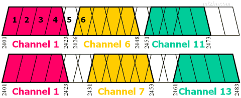

Wireless LANs, based on the 802.11b/g standard offer us the option of 13 different channels depending on which country we're in (14 in Japan). However these channels are not independent of each other, they overlap very significantly. The 13 European channels have centre frequencies from 2412 to 2472 MHz inclusive, spaced at 5 MHz intervals. However the bandwidth occupied by a transmitter is 22 MHz. This means that transmissions on channel 1 actually extend from 2401 to 2423 MHz. This overlaps with transmissions on channels 2, 3, 4 and 5, meaning the next 'clear' channel is number 6. Thus if our neighbour is using channel 1, we should only use channels from 6 upwards if we are to avoid direct interference. Likewise channel 6 overlaps with all channels from 2 to 10! Thus if we are to avoid interference we can only really use 3 channels, either 1, 6 and 11, or if we have the option, 1, 7 and 13 which will give a bit more separation and hence lower interference. The diagram below attempts to illustrate the situation.
