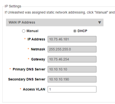

I see a document here: https://docs.commscope.com/bundle/unleashed-200.13-onlinehelp/page/GUID-3165BBFB-9B32-413F-A11F-95FC... which contains "Access VLAN" field:

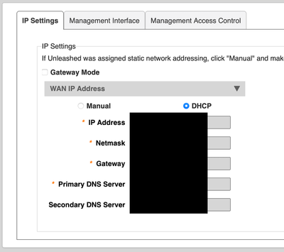

My AP, despite running 200.13.6.1.319 doesn't have such field:

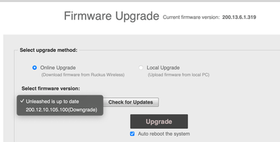

There doesn't seem to be any updates for R650 (my test one, I don't have a R750 not in production) as of today:

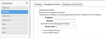

Click on the “management interface” tab and you’ll see the ‘enable VLAN’ checkbox.

Are you're talking about this screen:
This isn't it. It will not use DHCP, it uses any-cast and static addressing and it seems to be used for AP-AP communication. It doesn't enable VLAN on the main WAN interface in IP Settings like in docs.
