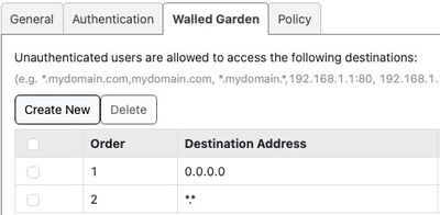

Created a SSID / WiFi Network with a Hotspot Service and added VLAN 100, Access Control, Radio Control, Others is default:
Hotspot Service has a redirection URL for unauthorized users to https://guestlogin.getcom.de:8003/index.php?zone=getcom_guest_net which is only reachable from VLAN 100:

If I check the client status it is telling me it is unauthorized:
The question is, how Ruckus unleashed is getting the information that the client is authenticated?
