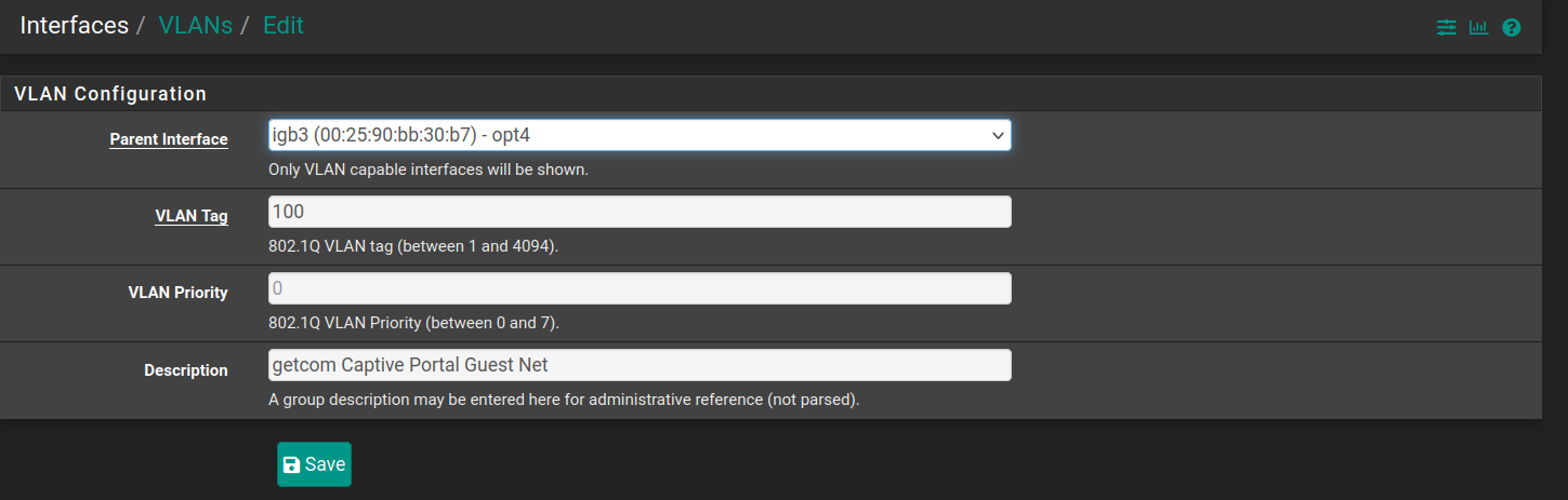

Adding a VLAN 100 on top of a physical link:

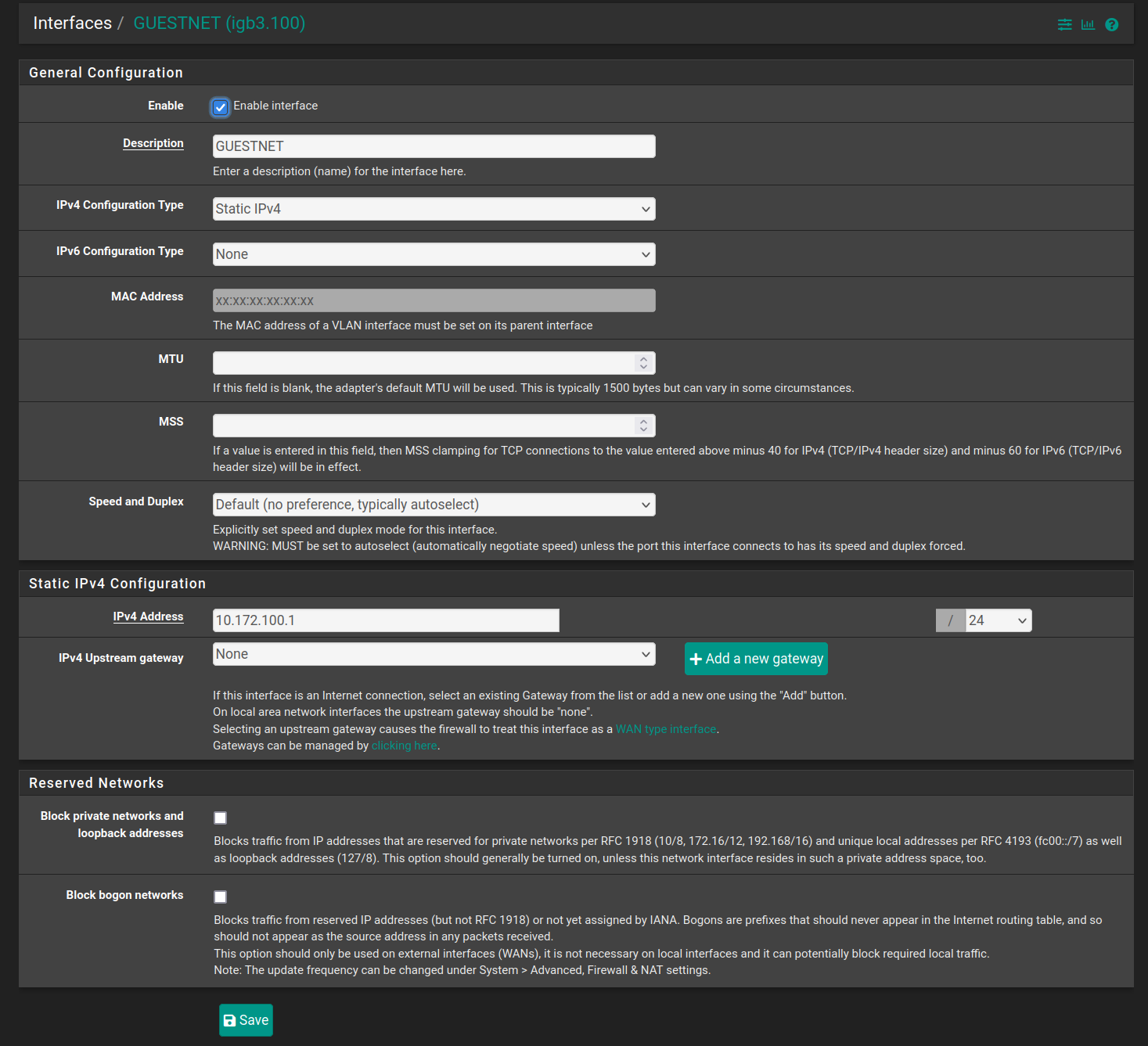

Creating a new interface GUESTNET on this VLAN with a static IPv4 address with CIDR 24:

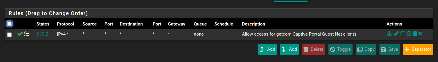

Adding a firewall rule for the GUESTNET with full access for testing:

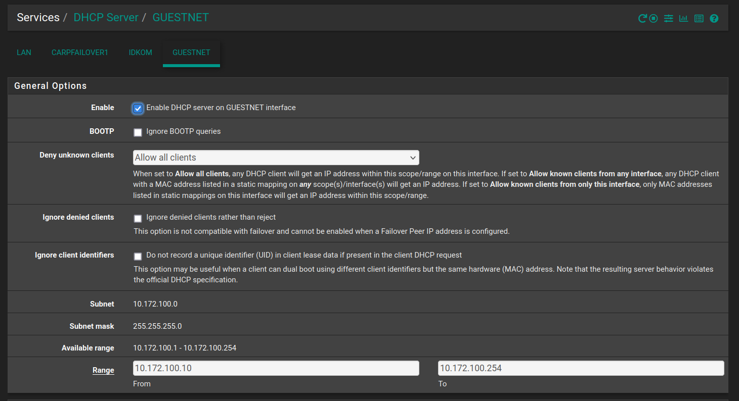

Enabled DHCP on GUESTNET with a range, no limitations, rest is default:

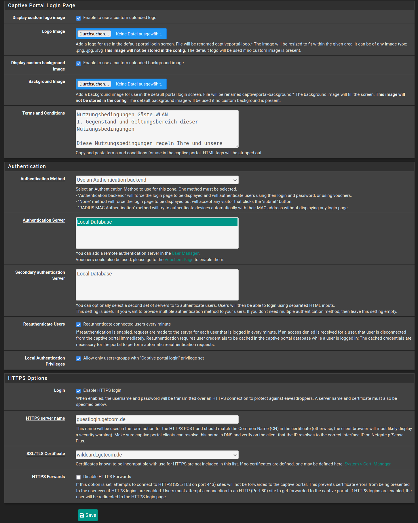

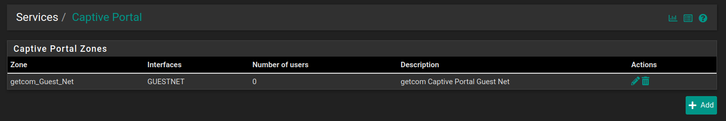

Adding a Captive Portal zone getcom_Guest_Net on interface GUESTNET with max 100 concurrent connections and a idle time of 1440 minutes, customized login page with terms and conditions and SSL enabled server name plus letsencrypt wildcard certificate:

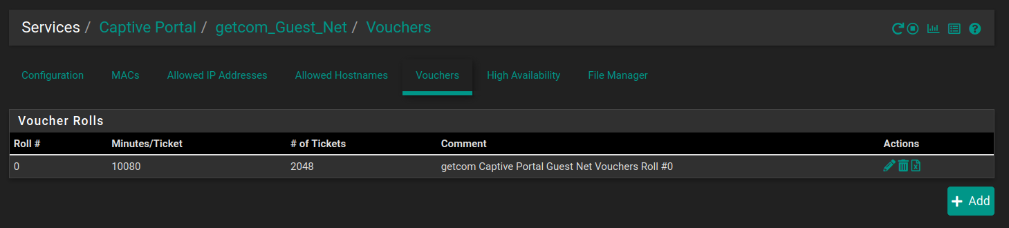

Creation of a Voucher list:

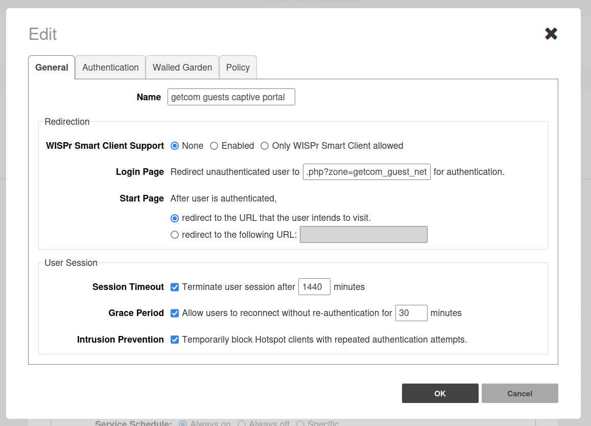

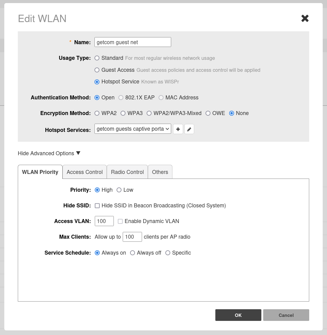

Created a SSID / WiFi Network with a Hotspot Service and added VLAN 100, Access Control, Radio Control, Others is default:
Hotspot Service has a redirection URL for unauthorized users to https://guestlogin.getcom.de:8003/index.php?zone=getcom_guest_net which is only reachable from VLAN 100:

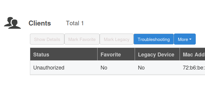

If I check the client status it is telling me it is unauthorized:
The question is, how Ruckus unleashed is getting the information that the client is authenticated?

The config looks fine, but the client is authenticated but Unleashed (Controller) does not know about it from the Captive portal.
You need to have POST configured on the pdSense which tells to the Unleashed about the client authorization.
Then the Auth status for the client on the Unleashed changes from "Unauthorized" to "Authorized".
