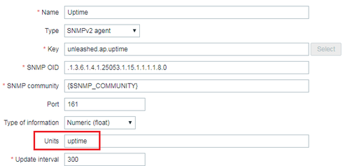

Hello all,
I am trying to monitoring Ruckus Unleashed in Zabbix with SMNP. I have 1 master AP and 4 members APs.
When I do a snmpget with Uptime OID to master AP I get correct data (35 days 4h 49 min 02 sec...):
But in Monitoring -> Overview I get wrong data:
In the Template I have configured Uptime unit in the Item:
I am very confused about that, is it possible to fix this issue? In Standalone APs, ZoneDirector and Virtual SmartZone I don ́t have this problem.
Thanks in advanced.

I have similar issue, but it is easily fixed with a "preprocessing -> custom multiplier"
Then the obtained value is the same as polling interval
But what is interesting, that snmpget properly reads the data
