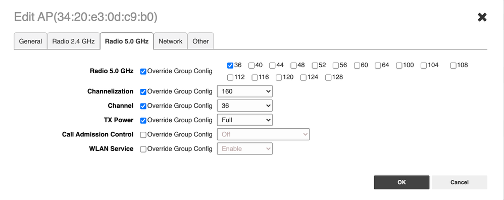

I still think you should first confirm channelization to make sure it isn't stuck at 40 MHz, and then survey for MCS/dBm.
Of course, no worries at all.
I'm checking that now! Thank you for the continued comments and help!
