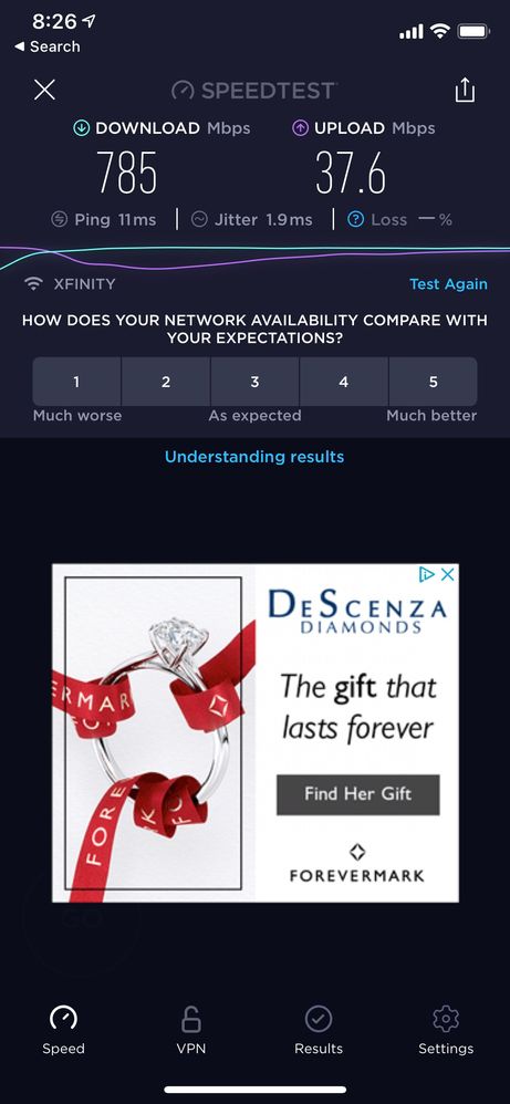

This is 7 ft from my R750 AP:
AP Rx Signal (dB) 40
AP Tx Data Rate 11/80/2 / 1.20G bps
And Ookla shows the following (1G down/35M up svc):
Image_ images_messages_5fbe5db4b6f95626499ba52f_eddb823272037f4016dd76396050713b_Screenshot20201125at8.26.40AM-25eb21a8-62a2-4891-a63e-7d50baf11440-1949563969.png
