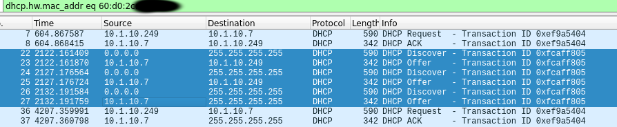

For whatever reason, the master AP - and only the master - sends a bunch of DHCPDISCOVER messages when it already has an active lease. The DHCP server dutifully responds with offers, which the AP ignores. Mikrotik's DHCP server interprets this as the client no longer being bound (it still respects the original lease time though, so my initial assumption that this could lead to address collisions was wrong).
Image_ images_messages_5ff80baca06270303c0b0ea4_cf1a1ddbbfb550550c67064af63f5840_Screenshotfrom20210107232723-12b6f3bf-11ad-4fa5-83b6-cd07ab007195-1871228169.png
Why does it broadcast DHCPDISCOVERs when it is already bound?

Sigh. The reboots, after all, do appear to be caused by Ruckus' faulty DHCP implementation, as a result of "heartbeats lost" events.
I see "heartbeats lost" events pretty much exactly the same time every hour, and, sure enough, they correspond exactly to when the master APs lease expire.
Similar issues have already been reported here and here in the past.
I have $10 gadgets that can do DHCP correctly. As already stated - a faulty DHCP implementation is shoddy for an "enterprise grade" networking appliance, and the fact that there are 2 year old reports of this same issue and Ruckus can't be bothered to fix the bug is beyond disappointing.

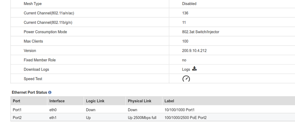

Thanks for the tips! The 720 claims it gets power via 802.3at:
Image_ images_messages_5ff76af1fa2b7165ca6c402e_ccb84becd5be1ae8482f0312bab19298_Screenshotfrom20210107113349-b4c135b4-7dc9-4e0f-8bb1-f894a4744f93-195789301.png
Also, the 8-10W range seems to be about right.
