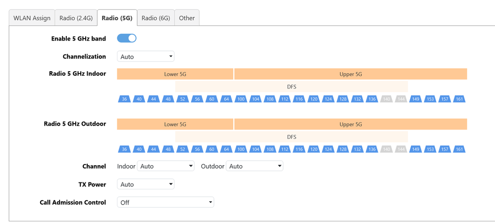

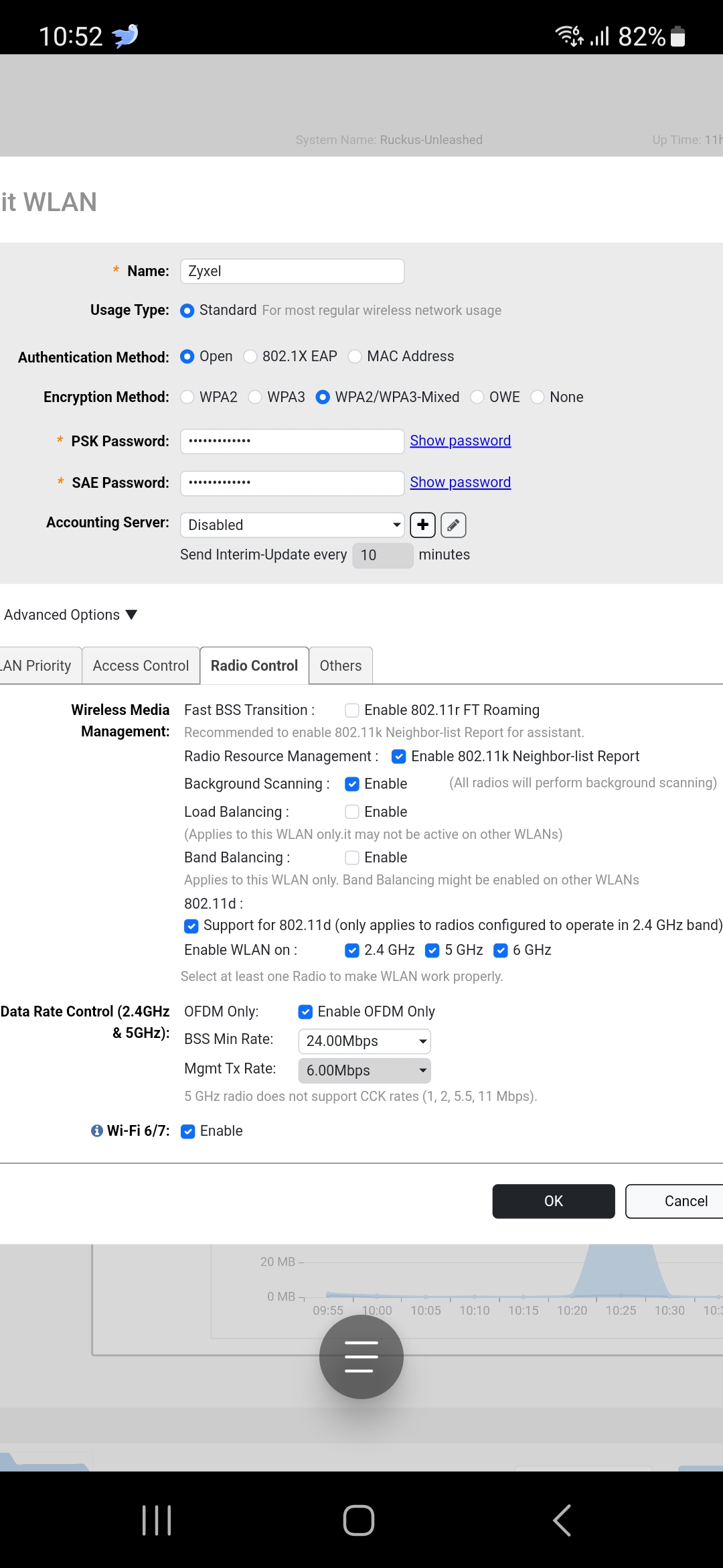

Hello. I need help. Problem with r650 (unliashed) - slow download - the maximum speed was 700mb. usually 600-650mb. Upload was 880-930mb. thus, I conclude that download=ax1800, upload=ax3600. Testing on different versions, latest 200.17, downgrading to 200.16, 200.15. Different devices - galaxy s23, ax201, ax211, mt7921. AP - to device. Local speed, not internet. 200.17 and 200.16 - iperf. 200.14 and 200.15 - SpeedFlex. Use default config and change (channelization-auto (client info-80mhz) in others-see screen) It's doesn't matter and it doesn't help. All devices show the same speed indicators. Everywhere there is a download below the upload. Thank you so much!

Hello @Geminius
Could you please confirm your wired speed? Have you checked the speed on the same client device by connecting to it through the LAN cable?
Which tool are you using to test the throughput? How many clients are connected to the SSID at the time of the issue?
Could you please check and confirm the client is connecting to the nearest AP?
Please check the same client throughput on the WPA-2 Encryption method as well.
