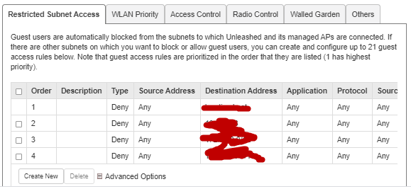

What I am trying to do is create a guest network for personal phones and ipads instead of it joining our main network where it's all mixed up with our computers and other devices.
I love how the Ruckus AP has a guest network section and it even configures the restricted subnet accesses automatically
Image_ images_messages_60adcd7cb706e8535ffe522b_a01757491c108387fc73464363cac810_ruckusrestrictedsubnetaccess-1e427cc2-1f46-4c4d-adb9-e214539acd85-745332576.png
But with the guest network, if we are using it for our personal phones and ipads, the captive portal appears everytime you connect to it, so my question is if there is a setting where I can completely remove that part and only have a password on there where users can connect to it on a daily basis without having to agree to the terms and conditions everytime OR is there a way to set up a standard network wifi with the restricted subnet access settings like the guest network does. Thanks in advance for your help!
