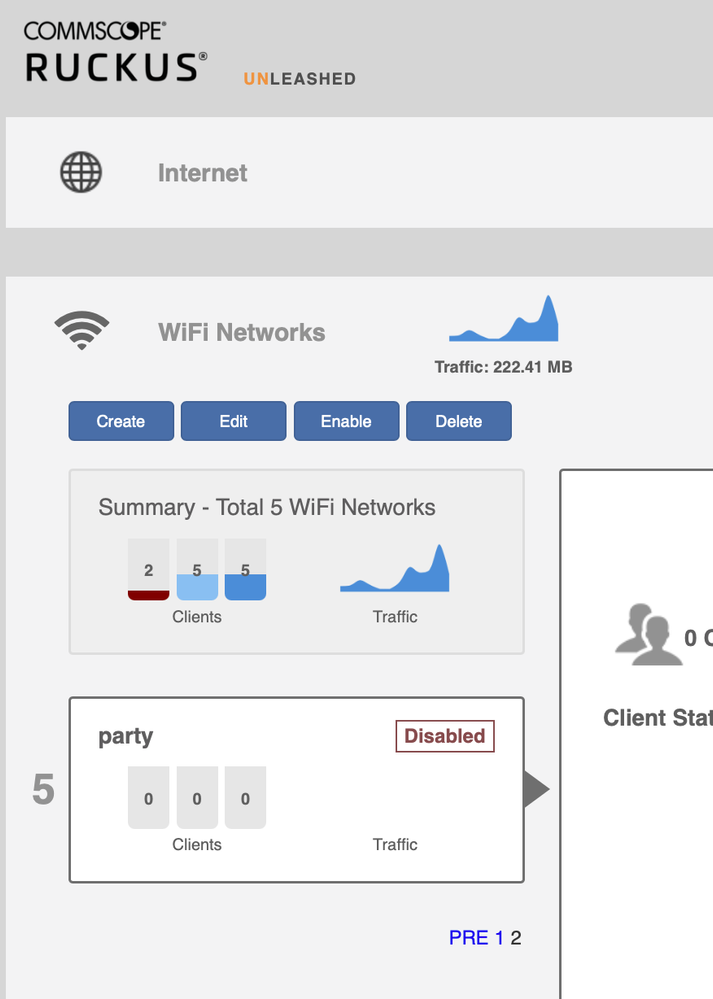

11-17-2020 11:56 PM
You can still access the Unleashed WebUI via the wired LAN port using a laptop or desktop with wired connection. Just visit https://unleashed.ruckuswireless.com and login using your Unleashed credential, then you can re-enable your WLAN via "WiFi Networks" -> WLAN -> Enable. See below screenshot.
