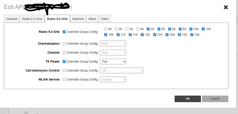

I have noticed that my client shows between 10 and 40 Mbit/s in speedtest.net, but I am connected to a 5GHz SSID. I run 200.15.6.212.27 and the client is close enough to the AP. It is a Lenovo Win11 computer, "netsh wlan show interfaces" shows that i am well on the 5GHz Band, Signal is 75% and RSSI is -55.
As soon as I disable the 5GHz on this AP and then re-enable it, my speedtest shows >200Mbit/s. The same happens if I block all 5G clients on this AP. Blocking 5G clients on the same ssid is not enough (I have four SSIDs running). Also the problem seems to be limited to this one AP. Upload alwas is a bit better than download and an upgrade to 200.18 didn't change the behaviour.

Your understanding is correct. I have not performed a factory reset, but I had the problem with a R350e before so I exchanged it with a R550 which was in the same installation but on another spot. The problem has persisted with the location but not with the AP.
In the meantime I also forced the AP to switch to another channel but without success. I could also factory reset if you think this could help.
