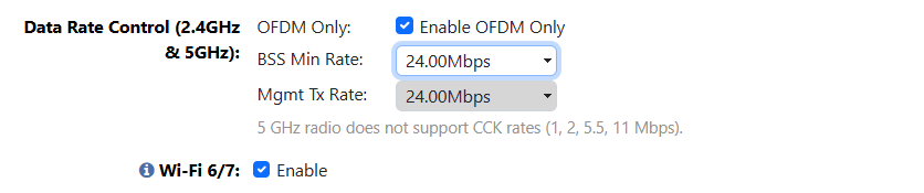

When changing anyting in Radio Control for a WiFi Network, I lose the ability to set a Mgmt Tx Rate of 24 Mbps.
I've tried toggling Enable OFDM Only on and off, and selecting different BSS Min Rates but once a change has been made Mgmt Tx Rate is stuck at 6.

I just tried the same in my R350 AP as, but when I enable OFDM Only option, I can still see "Mgmt Tx Rate" changing when I change "BSS Min Rate"
For now I only have OFDM Only option enabled, all other settings are default ones.
Can you check if there is any other settings are enabled which is causing this issue in your setup?

@sanjay_kumar on my setup, when I change the BSS Min Rate, the Mgmt Tx Rate also changes in lockstep but after I save and come back to this tab, the Mgmt Tx Rate reverts back to 6 Mbps.
Hi Zuul,
Thanks, I can see the issue now. Let me work on this.
