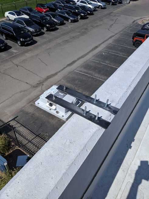

Do you have more photos?
andrew_giancol1
Contributor III
Welp, we just mounted a t300 and can see the pressure valve is open to the elements. i'll get back to you as to whether the pressure valve theory holds water.Image_ images_messages_5f91c459135b77e247a38e12_69bbf8ec30c2dd46d61a3fb33cea9d7d_RackMultipart20190614697372xez-b8d37c12-d18f-4853-9e02-41f5b0813741-701200929.jpg1560549017
ron_henry_7uwsm
Having one of several T300 just experience a failure because of this issue, the water isn't penetrating the pressure relief valve. It is getting into the radios because of a tiny (alignment?) port drilled through the back cover near the Ethernet port.  Your test setup is flawed because you put a shield over the top (your right mounting plate in this image) of it in your test radio image. That bar will minimize water penetration.  Take a dead T300, pour some water in it and hold it with the corner next to the Ethernet port down.  You will see the water readily drip out.
