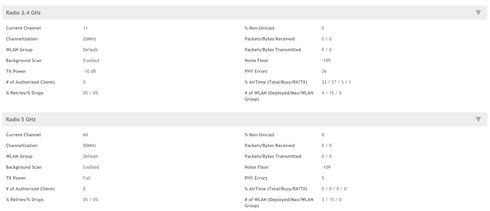

I've been seeing really high channel utilization figures so am trying to understand root cause. Ive disconnected all wifi devices other than my MacBook to run some diagnostics software and Ruckus vSZ-E and still see 20% utilization (sometimes peaking at closer to 50%).
I have 3 SSIDs on 5Ghz and 4 on 2.4Ghz (IoT subnet)
Im curious if this is expected behavior with the AX chipset or a config error by a somewhat new to Ruckus user.

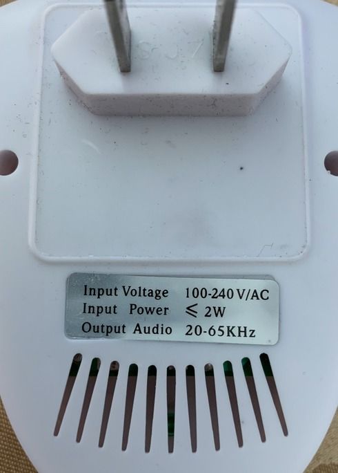

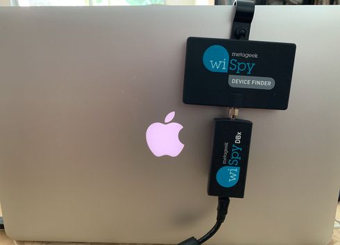

Update. I went back to the three r720s which I knew worked and started debugging. I found the source of noise using my WiSpy hardware! I discovered the wife had recently plugged in some wireless mosquito repellers she bought of eBay which were flooding the wireless frequency range. 2.4Ghz scan looks much cleaner now. I do however still see 20% utilization on the R730 with few clients. I'm still debugging.
