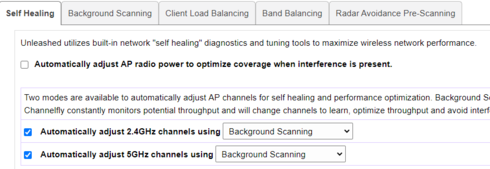

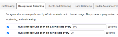

Finally is there a way to switch b&g off on the 2.4ghz. I have 2 wireless SSIDs. One for 5ghz only and the other for 2.4ghz.
[Omer] You can disable it, refer below screenshots. However, I do NOT suggest disabling it. Set the background scan internval from default 20 seconds to 600 or 1000 seconds.

Hi Omar,
Does that not just switch 2.4ghz off completely? I want 2.4ghz to work but on the n only and switch off the b&g protocols.
Regards
No, it will just disable the background scanning for 2.4GHz radio.
