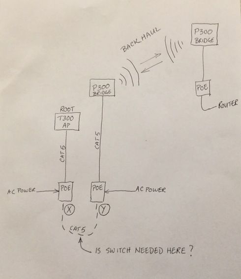

Does the connection between a T300 root AP and a P300 point-to-point backhaul require the use of a switch in an unleashed network? This seems to be the case from the specs I have seen on each unit. The attached image is what I had in mind but I am not sure if I can make the link between X any Y in the diagram without a switch. I don't need to attach any other devices other than wirelessly.Image_ images_messages_5f91c3ee135b77e2478ed285_973f4d24fb2a7afc8e5502ed20ae9edf_RackMultipart20170412170141kqh-bf40aecd-43f1-42aa-83bb-b8d0363cddc9-655193077.JPG1491973556

this is doable and should not be a problematic setup and has been done before.
May i know what is the concern you may have??
As long as all devices are in on L2 domain, T300 talking to master AP via this P2p link should not be a concern as i think worst could be that T300 may not bcom master AP in this topology
