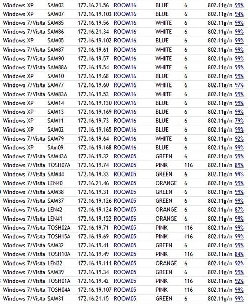

Here's a shot of the laptops on those APs. A few less than 17/23 split as I took it later. But it does show a mix of laptops (Samsung - 2 models, Lenovo and Toshiba) spread over APs Room05 and Room16.
The Toshibas (newest) are using 5GHz and all laptops report strong signal. Looks good to me - wish all the other APs did the same.
