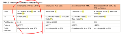

Customer is using SCI and vSZ(above 3.5).
But thier SCI don't use 8443 port.
We can see some port using connection SCI and vSZ on document.

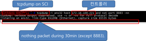

But SCI don't use 8443 in result I check it using tcpdump on SCI shell.
SCI reciecve only packets for 8883 port from vSZ.
Image_ images_messages_5f91c3e8135b77e2478db496_2405c6cfac7b1fe9ee477b3247b30c79_RackMultipart20170901171711fax-6fe27d1e-6011-42cc-b71a-4b583b506802-1789673450.png1504231247
Doesn't it use outbound-8443 port?
Is it intended?
Should we only open inbound tcp 8883 port from vSZ to SCI?
