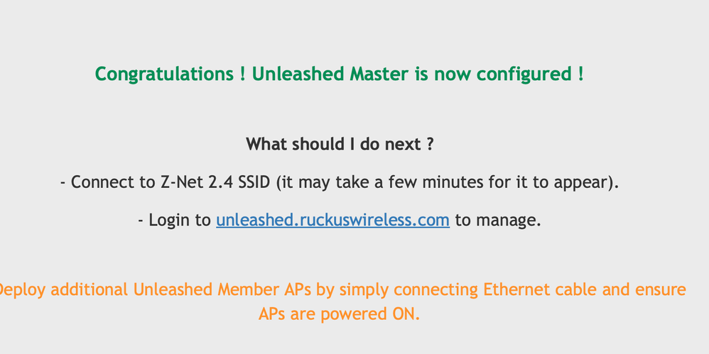

so i went through the steps... and got confirmation of the new network has been set up. the problem is that the AP is still blinking green both Power and CTL - the other AP's are unplugged and I don't see the new network showing up in wifi... i only see the ATT wifi and configure.me.
thoughts?

so nothing seems to be working now... so i reset the AP... still nothing. I unplugged the IPX-7150... and the lights did not go green (see below). So i unplugged again.. this time the lights all turned green. the AP CTL is solid green, but the power is flashing green. i don't see the "Z-Net 2.4" network that i created (pic in last post)... i only see the ATT wifi and the configure.me. I connected to the configure.me and logged in with the admin credentials and this is what i see
