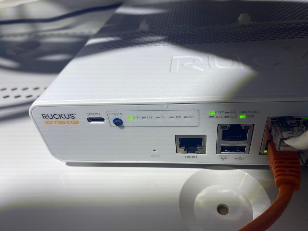

I am having a similar issue.  rebooting (cycling off and on) multiple time per day, random time frames.  I have power cycled the modem and switch and rest the APs but still cycling.
The switch is a ICX 7150-C12P.  The lights that are on are the Port Link Status, System Status and Power.  All are green.
