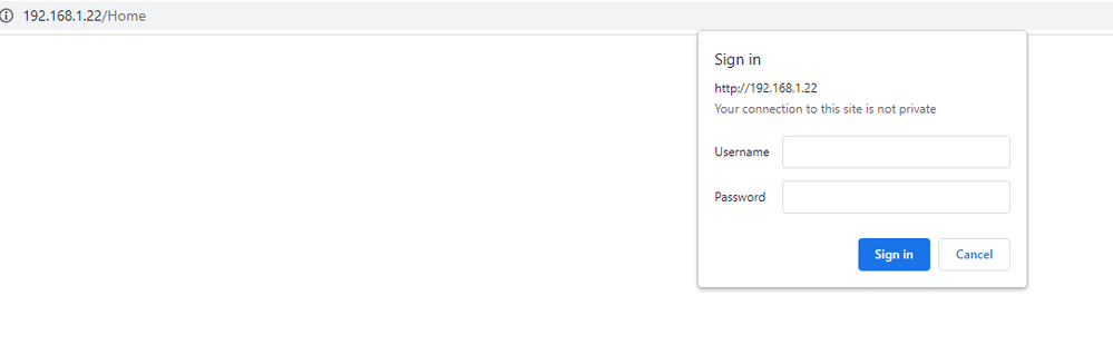

I was able to find the ip address of the switch using an ip scanner. But the username and password does not wrking. I even reset the switch to set to factory state. But the user name and password is not working. Any idea what the combination could be?

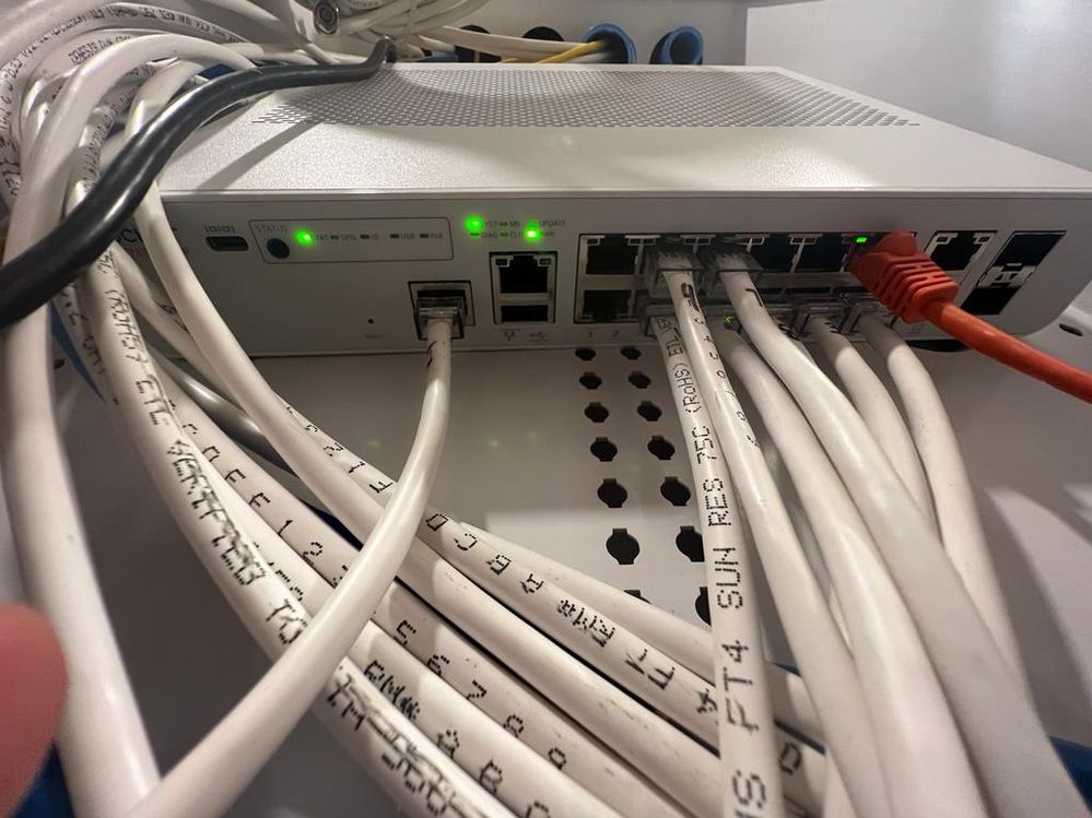

2. On your switch while it's plugged into the outlet, do you see any lights on? (Amber or green) Please let us know which lights are on. (Please refer to the below picture and share a picture of the same showing the light status and cable connections to the Switch)

Please help us with pictures of your ICX-7150-C12P Switch showing the status of the lights. Also, light the status of Access Points.

This switch has two access points and it was working just fine more than an year. Recently when I connected to the unleashed network it prompted for a firmware update for APs, I did that and from then it stopped working. When I researched it was told that the firmeware version of the switch might be older and that could be the reason I cannot access network. I am unable to connect to the configure.me networks even if it shows up in the wifi list. So I was hoping to update the firmware on the switch. But I was unable to connect to it. I did run a ip scanner and tried to connect to webgui, but none of the password combinations are working including the one on the back of the box. webgui.pngWhatsApp Image 2023-05-26 at 5.00.58 PM.jpeg
Hi @smriti
Could you please let me know where the ethernet cable is coming from which is marked in the below screenshot?
