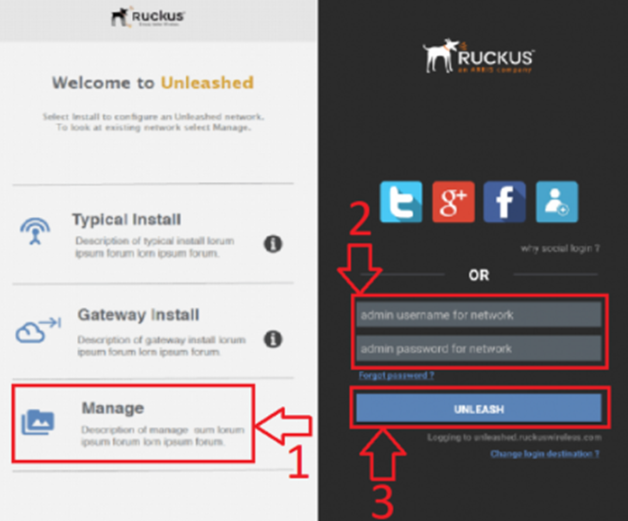

If the master access point changes, should I be logging in with a different IP address?
Hi @nsmith2
Thank you for your response.
As mentioned earlier, there’s no need to log in using the IP address. Instead, please use your username and password under the “Manage Network” option in the Unleashed application.
Ensure that your mobile device is connected to the RUCKUS Access Point's Wi-Fi  network when logging in.
