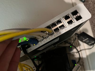

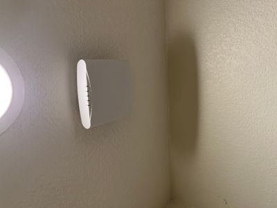

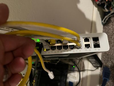

As far as I know there were no power outages before the problem started. There are green lights by the input port and at the power and syst lights. Amber lights at ports 1-3. No lights at ports 4-6. I attached pictures to show. I stated that I’m not getting Poe at the access points, so no WiFi. But also get nothing from the other ports running things like ring and lutron. Thanks for help.

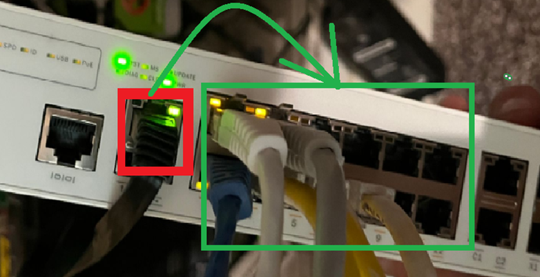

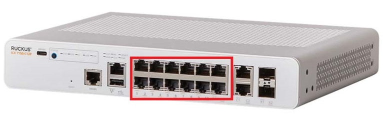

Please unplug and plug the Access Points ethernet cable from the Switch ports to any other 12 ports (refer to the below screenshot)
Based on the light status indicators of the RUCKUS ICX-7150-C12P Switch, it appears to be in a normal state.
Additionally, from the picture you shared, it seems that the Ethernet cable from your ISP’s router or modem/router combo is connected to the incorrect port on the switch. It should be plugged into one of the 12 designated input ports, as shown in the screenshot below.
Please unplug the ISP Ethernet cable and connect it to the correct port. Additionally, reboot your ISP router by disconnecting it from the power outlet and then plugging it back in. After doing so, please attempt to check and connect to the Internet via the Access Points.

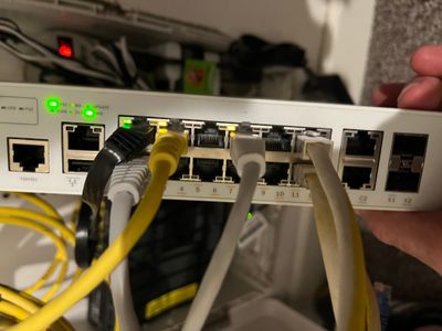

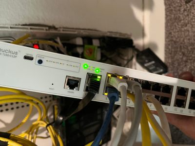

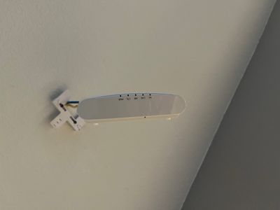

sorry. When reconnecting for picture purposes I did put the input in the wrong port. Sent new pics with working devices and good lights on the first few ports. Moved the two access points to 11 and 12 ports and get no lights. Not sure if that’s the switch not putting out Poe of did both access points fail at the same time, seems unlikely. Thanks for the help and sorry for my mistake. Hope the new pics and info help with diagnosis.
