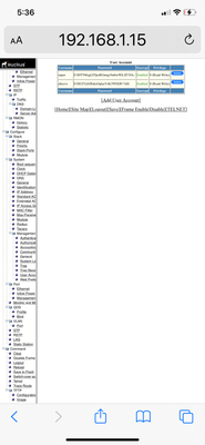

Will do . I tried the default password for the switch sp-admin to no avail. I can sign into the config page with router with the password I created . The attach photo shows two users and passwords what are they for?
07-28-2023 03:01 PM
Hi @tc6string
Those are the username and passwords (Encrypted) which are saved in the Switch configuration. There will be default usernames and it gets updates when you add any other credentials.
As you are able to access the Switch GUI, Could you please help me with the information shown in the below screenshot?
