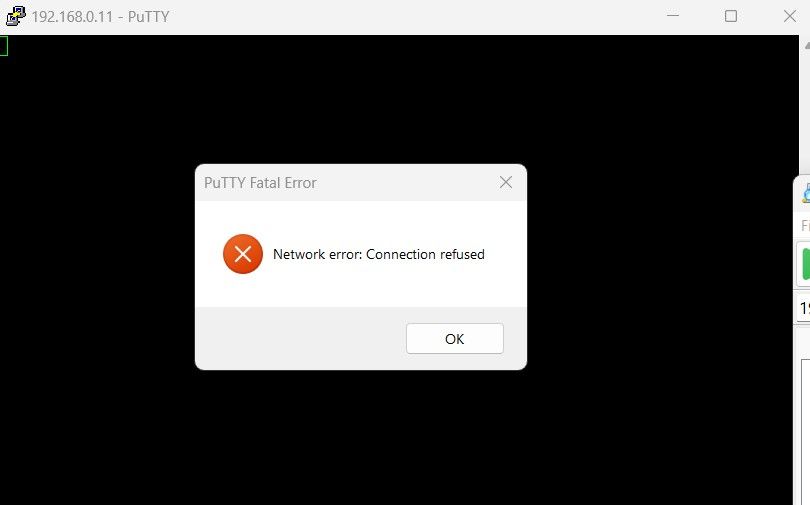

When I scan, two Ruckus IPs come up. I have a Switch and 2 WAPs, but only two IPs show up. One pulls up the WAP page as the Guide indicates. The other states that the IP address refused to connect. So I am not able to verify that address and when I try that address, it doesn't connect in PuTTY, so I have been unable to access the CLI I tried a factory reset of the Switch, but that did not resolve my issue.

3. The IP address by which you are getting the ‘connection refused’ error, use the same IP Address and try to access CLI using the Telnet option and check if you can access. (Refer to the below screenshot)
Telnet – Port 23 (If SSH doesn’t work)

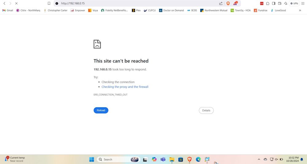

1. 192.168.0.15 results in the Access Point page in the Guide document. 192.168.0.11 does not connect.

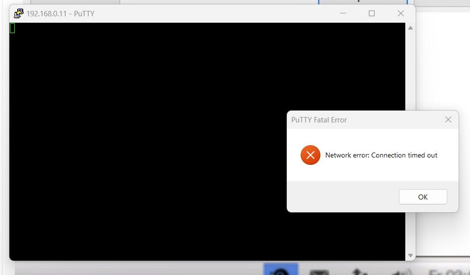

4. I get the below error when I try to access via Telnet.

Please try with another RUCKUS IP address from your IP Scan list. That is 192.168.0.15

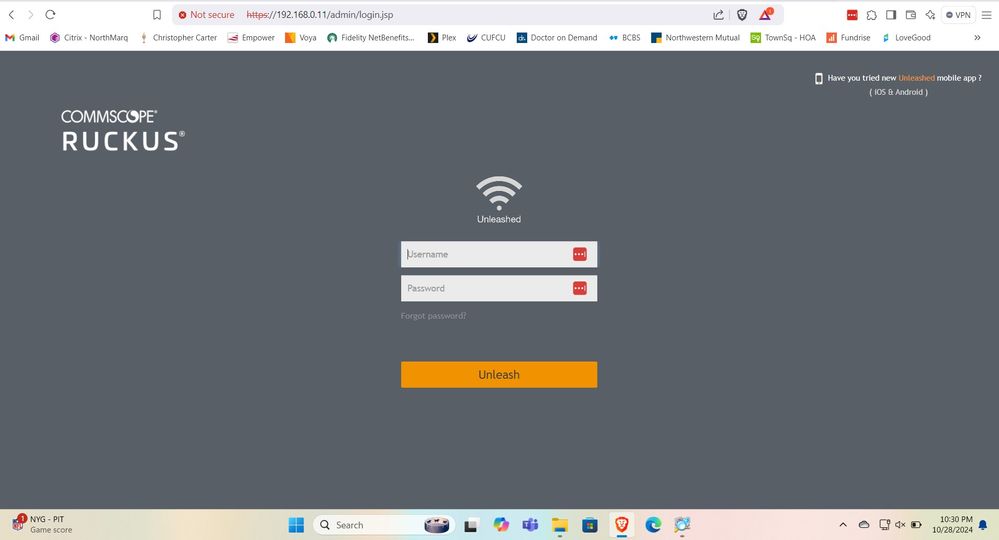

10-28-2024 08:39 PM
I cannot get the dashboard shown under either IP address. It seems to have switched though, as 192.168.0.11 now gives me the Access Point dashboard. This was not the case last time I tried. However, neither of the IP addresses will connect to the CLI via Telnet login. My wife and I have to work during the day, so I have had to connect the internet to our other router during the day and reconnect to the switch to try to work on this problem in the evening.
