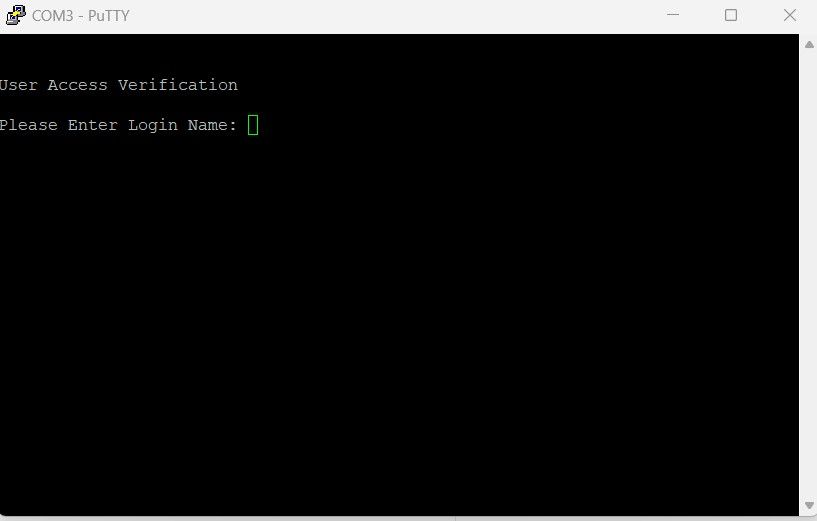

10-30-2024 09:07 PM
I downloaded the driver and confirmed the correct port, but I am not getting a prompt when I open up the CLI. It asked me for login info. I tried to use the info in the default passwords guide, but it would not allow me to enter a password.
10-31-2024 05:21 AM
Hi @isaaccloos
Once again please try the below mentioned default credentials.
Username: super
Password: sp-admin
If the above credentials don’t work, you can try below default credential combinations as well.
If that doesn't work, the next step is to recover the username password.
While you have the laptop connected to the Switch with a console USB cable and the CLI screen up it asking a username/password, reboot (unplug and plug from the power outlet), and follow the video below.
https://www.youtube.com/watch?v=0ynKwSTpd_A
Once you have successfully recovered the switch password, use the following commands to either modify the existing password or create a new username and password:
configure terminal
device(config)#username super password pass
In this example, the username is ‘super’ and the password is ‘pass’.
To ensure proper authentication, execute the following commands:
device(config)#crypto key generate rsa
device(config)#aaa authentication login default local
device(config)#aaa authentication web-server default local
