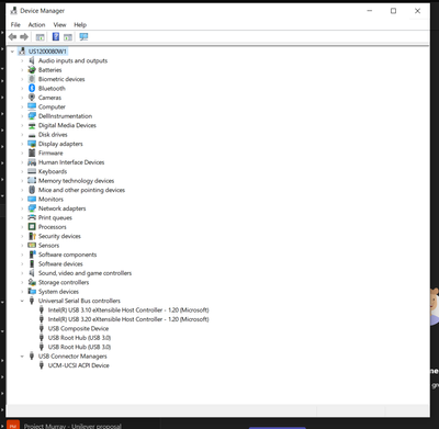

I followed the cable method, some reason MobaXterm is not downloading. I went into device manager to locate the Serial for Putty, but my device manager doesn't locate the "COMx" serial. I tried both a type to type connector and a type c to usb, neither are working

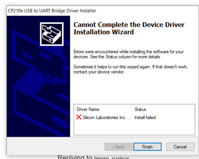

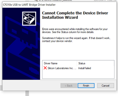

the driver installation is failing both on MAC and windows laptop ... see screen below

Assuming I needed to update the firmware on Switch, I attempted to folow the below article ... however this takes me back to the URL search of my Switch and I can't find my switch login page by searching in the URL. Using hardwire to connect to my switch requires device
manager to identify the Switch and it wont. Feels like im stuck again

1. Once again, please make sure to download the zip drive for the file below & "extract all". Once it's extracted, run the file, the driver should be installed using the 2 links below.
Link 1: https://support.ruckuswireless.com/software/1414-brocade-ruckus-7150-usb-serial-driver-windows
Link 2: silabs.com/developers/usb-to-uart-bridge-vcp-drivers?tab=downloads
Once installed restart your laptop and try to locate the COM port details under 'Ports (COM & LTP)' with cables connected between the Laptop and the Switch (Refer to the below screenshot), Please check and let me know if that works.
Let me know if you see Switch is device manager and access Console CLI.

Imran, ONCE AGAIN, if you see the screenshots above I have downloaded the driver zips and when I extract all Im getting the error below...
I also restarted my laptop and connected the cables and don't see the PORT (COMx) in my device manager (see below)
