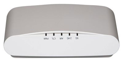

The router upstairs shows two yellow lights

Basically, the yellow light means that there are not clients connected on that specific Radio (5G or 2.4G) that depends where is the yellow light on.
This does not mean that the Access Point is broken or damaged.
Here is the meaning of each light on the Wireless Access Point
https://docs.commscope.com/bundle/unleashed-200.9-onlinehelp/page/GUID-19D4261B-D10B-4DE3-B63A-3498F...
Yellows light 2.4G: Radio is up, no clients are connected to the 2.4 GHz radio.
Yellows light 5G: Radio is up, no clients are connected to the 5 GHz radio.
So, if there is a device (iPhone) that is using the 5G radio, the light on the Access Point will be turning green on the 5G radio indicating that there is a client/device using that radio (5G)

I don’t have Radio 5G. The lights turned yellow after resetting the actually assess points. Now my Butlers2 wifi will not show up and I cannot log into the unleashed app because it’s associated with Butlers2. How do I fix this ?
