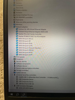

Hi Imran,
Please find the below requested screenshots.
Hi @tandemsankar
Thank you for the response and for sharing the requested information.
Have you installed the RUCKUS Switch drivers on your Windows laptop? If not, please follow the below process and try to access the Switch console once again.
Please make sure to download the zip drive for the file below & "extract all". Once it's extracted, run the file, and the driver should be installed.
Link:https://support.ruckuswireless.com/software/1414-brocade-ruckus-7150-usb-serial-driver-windows
Link: silabs.com/developers/usb-to-uart-bridge-vcp-drivers?tab=downloads

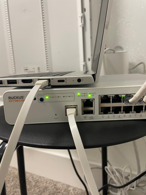

Also, please try to access the Switch console using a USB Type-C cable once. (Please refer to the below screenshot)
Hi Imran.
As per instructions, I have downloaded & install the drivers. Still the console ports are not responding.
I have tried with USB-c option also, port not responding.
I have strong feeling its hard failure/ port failure. I will wait for your (experts) review comments.
