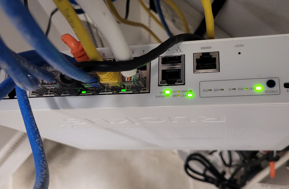

2. On your switch while it's plugged into the outlet, do you see any lights on? (Amber or green) Please let us know which lights are on. (Please refer to the below picture and share a picture of the same, showing the light status and the FULL Switch panel cable connections to the Switch ports)

2. Attached pictures

As per the picture you shared, the light status of the RUCKUS ICX-7150-C12P Switch is in the normal state.
Could you please unplug and plug the Access Point’s ethernet cable from the Switch port? You can plug it into any 1 in-12 ports highlighted in the below screenshot. If required, you can reboot (unplug and plug from the power outlet) your RUCKUS ICX-7150-C12P Switch once.

Thank you Imran! That worked. I appreciate your assistance.
