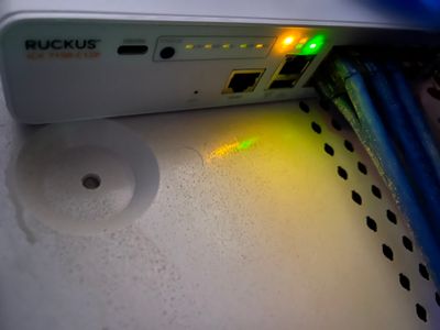

2. May I know how many Access Points are connected to the Switch? Could you please let me know the light status on the Access Points? Any of these lights are on (Please refer to the below picture and share a picture of the same)
01-19-2024 06:58 AM
Power light is green, status light is amber/orange. No switch access ports have activity or link lights. Ceiling AP's(3) do not have power over Ethernet - no lights.
