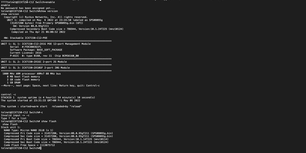

Hi @ynv_naw
Is your Switch upgrade completed?
Please share the output of the below commands to check the same.
show version
show flash
03-19-2024 02:38 PM
Hi @ Imran_ruckus:
Please find screenshot below. Looks like it has upgraded successfully but the switch is not showing still on the ruckus dashboard. I tried to add using the add option and the message/screenshot is below:
